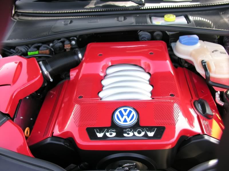

    I treated some plastic textured engine cover parts with #40 now I am thinking of painting those same pieces.
    Is there something I can use to remove the #40 so I don't end up with fish eyes when I spray them .. I'll be using Plasti-Cote caliper paint which I have used before for the same job.
    Parts in question
    Proposed end result ( different car )
