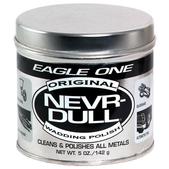

    Eagle One Nevr-DULL Now this was just to much surface area for this. From my navy days there is nothing better on copper or brass stuffy thingy. Just you go through lots of wadding for large project. Not bad product though.
    http://www.eagleone.com/nevr-dull-wadding-polish
